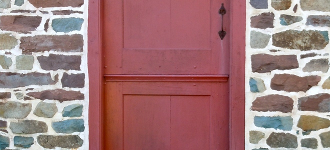

A Dutch door is an unusual and attractive option for an exterior or interior door. This unique addition will serve functional purposes as well as provide a decorative touch to your home.
You can create this split door from an existing door in your home, resulting in your own unique, and functional, entrance. This project works best with a solid wood exterior door, particularly one with a four-panel design.
This task does require advanced woodworking skills but can produce a charming and ornamental result.

Step 4 - Cut the Door
Remove the door from the hinges again. Lay it across the sawhorses. Decide where you want to make the cut; often on the center rail of a solid wood door, but not necessarily.
Using a straightedge, carefully measure a straight line across the door, then draw another 1/4” away. You will need four sawhorses all together as you cut on each of these lines with a circular saw. This ¼ inch will allow the door top and bottom to swing freely.
