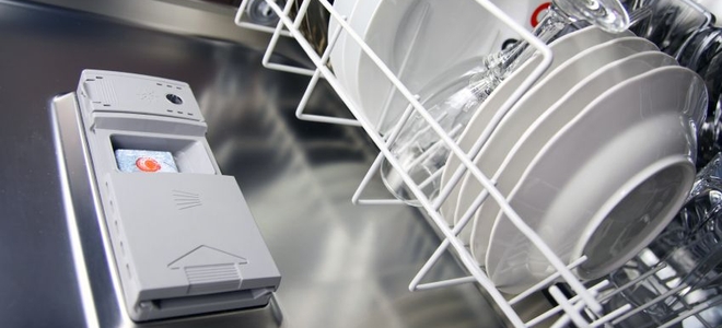

If you find yourself troubleshooting a dishwasher that won't drain, you won't be the first person to have faced this challenge. Although there can be a number of reasons for a dishwasher's failure to drain, it shouldn't present a major challenge for you to find and fix the problem. There are actually a limited number of reasons your dishwasher may not be draining. Follow the troubleshooting steps below to get your dishwasher working again.
Step 1 – Check for Clogs
First, check the sump (bottom) area of your dishwasher. If you have more than one or two cups of water there, use a container and remove as much of it as you can. Then, check to see if there is food debris, paper, or other scraps that might be clogging the drain. If upon first checking, you find only a small amount of water, this is not necessarily a sign that your dishwasher is not draining. Typically, there is a small amount of water intentionally left there to keep the seal from drying out.
