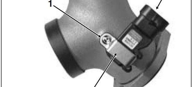

MAP Sensor Location
The MAP sensor can be located on the intake manifold, slightly embedded in the manifold, as an integral part of the ECM, or just secured to an auto firewall and connected to the intake manifold with a length of flexible hose and to the ECM via the wiring harness. The service manual will help you find and identify the MAP sensor.
MAP sensor

MAP sensor viewed from connector end
Replacing MAP Sensor
MAP sensors are not easily repaired, so they're usually replaced to expedite the repair. MAP sensors are not costly, and they're usually simple to replace. You must take care when removing the old MAP sensor, as the fasteners are very small and can be easily broken. A squirt of penetrating oil on each fastener before attempting to remove it is highly recommended. Get the penetrating oil into the threaded portion of the fastener and wait a few minutes for the penetrating oil to work before removing the fastener.
Carefully unplug the wiring harness and plug in the new MAP sensor and reattach it in the position where you removed the old one. Reconnect any flexible hoses you disconnected previously.
MAP sensor
