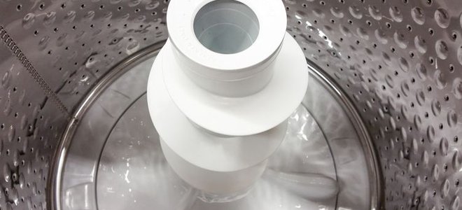

If the washing machine drain in your machine is not working properly, it could result in a flood in your laundry room. Therefore, if you notice overflowing from your machine, tackle the problem as soon as possible. Fortunately, washing machines are relatively simple mechanical devices and you can probably repair the problem yourself. This easy to follow step by step guide will show you how.
Step 1 - Diagnose Problem
Before you can fix the overflow with your washing machine, you will need to diagnose the faulty component that is causing the problem. First, turn on your washing machine and fill it about halfway full of water. Then, unplug the machine. If the machine continues to fill, the problem is probably mechanical and means that the fill valve is stuck or faulty. However, if the machine stops filling with water, then the fill valve is probably fine.
Next, unscrew the panel on the back of the washing machine that allows you to access the wiring and switches. Look for a switch that has a tube attached to it. Disconnect the tube and blow it out to make sure it's not clogged. Inspect the tube to make sure it's not damaged or does not have any holes in it. Replace the hose and try filling the machine again. In some cases, this may actually fix the problem. If it does not, try blowing into the hose while it is connected to the pressure switch. If the switch is working you should hear two clicks. If you don't hear the two clicks, you'll need to replace the switch.
