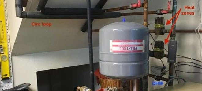

boiler
A clogged burner nozzle may be responsible for this. The nozzle has an extremely tiny opening that could get clogged with mineral deposits or dirt. Change the nozzle and see if the boiler will heat. It is also possible that your fuel may be contaminated with dirt and water. As oil is being pumped into the tank you’ll need to shut the furnace off for about an hour. This will allow dirt to settle at the bottom of the tank. You should also ensure that the tank is topped off with fuel. This will keep the sediments at the bottom from being disturbed as much as infrequent fill-ups do. To check for presence of water in the tank, apply some water-sensitive paste onto a long stick. Dip into the tank. If it indicates water, you’ll have to drain the tank and inspect it for cracks. Arrange to repair all cracks.
