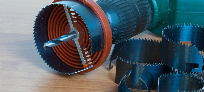

A hole saw.

A relatively common problem with a hole saw is for a slug of wood to become stuck in the saw. You can buy a slug ejector tool to remove them, but this costs money you don’t need to spend.
If you look at the blade of the hole saw you’ll notice two small holes in the back. You can insert small objects into both of these and push down to remove the slug. An alternative method is to drive a pair of screws into the slug from the underside and then pull the slug out with a pair of pliers. Both these methods will work well and cost you absolutely nothing except a short amount of time.
