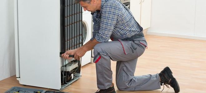

Cleaning the Condenser Coils
A man works on a fridge.
The condenser coils can be cleaned easily with a vacuum and a duster. Simply stroke the duster at the coils to remove the dust. In order not to allow the dust to stick back to the coils, use a vacuum cleaner to suck it up. The duster can easily remove the dust from the coils but may not easily remove grime that is sticking to them.
To remove grime, wipe the coils with a rag soaked in soapy water. But do this only when the fridge is unplugged. The damp rag will easily remove the grime that is stubbornly sticking on the coils. If not, use a coil brush. Since a rag may not be sufficient enough to remove grime from hard to reach areas, the brush can be used for further cleaning. Afterward, wipe the coils with a clean dry cloth. Before plugging the unit back, allow the coils to dry completely.
Cleaning the coils should be done at least once a year for maintenance. If there are pets inside the house, then every 6 months is a better option.
