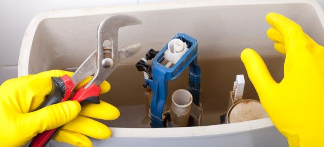

gloved hands fixing open toilet tank with plumbing wrench
Plumbing problems are stressful, especially when they're happening to your toilet. After all, the toilet may just be the most essential piece of plumbing in your entire house! There are a number of things that can go wrong with your toilet and it's always the wrong time for any of those things to happen. Here's how to handle the most common issues.

2. Running Toilet
If you hear your toilet running when it shouldn't be running, you have an extremely common plumbing problem. Your flapper is worn out, which happens all the time and is actually a very easy fix. The flapper is a rubber stopper inside your toilet tank. When you flush the toilet, the toilet handle is attached to a chain that lifts up the flapper in order to release the water from the tank when the water in the bowl is flushed.
When the flapper begins to wear out, the seal between the tank and the bowl becomes weaker and this allows water to leak from the tank into the bowl. That's why you hear the sound of the water running sometimes, or all the time.
toilet flapper ribber on chain
The flapper is one of the least expensive pieces on any toilet and it's very easy to find. You can purchase a flapper at any home improvement store. Shut off the water to your toilet using the shut-off valve located on the pipes. Remove the flapper from the tank ad take it with you when you buy a new flapper, so you can be sure you get the right size. Simply replace the old flapper with a new one and you have easily solved this plumbing problem.
