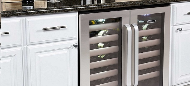

Many wine cooler problems can be solved easily without having to pay for a service call from a professional.

The wine should be stored at a constant temperature between forty and sixty-five degrees Fahrenheit. If you are unsure of the temperature in your wine cooler, place a digital thermometer inside to detect the temperature level.
If the wine cooler temperature is too warm, check the temperature control to be sure it has been set properly. Stabilize the cooler by turning the temperature control to a lower level for a few hours. Be sure the door and door gasket to the cooler is sealing properly. Check the electrical outlet to see if the unit is connected.
If the temperature is too cold, check the temperature control. Stabilize the temperature by adjusting the temperature control to a warmer level for a few hours. Make sure the cooler is standing on a level surface. If necessary, use a shim or move the cooler to a more level location.

If the wine cooler is not working, make sure it is plugged in. Check the fuse box to be sure the breaker to the outlet providing power to the cooler is operating properly. A door that does not close properly may be on a surface that is not level or the door gasket may need cleaning. If the wine cooler is emitting vibrations, turn off the power by unplugging it. Contact the manufacturer of your cooler if you are unable to solve a problem.
