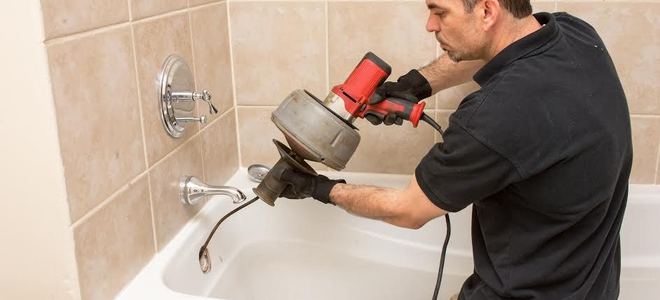

The snake will be wound up on a reel drum with a wing nut that keeps the snake in place on the drum. Loosen this nut, pull some of the snake off the drum, and push the end of the snake through the port opening. Be sure that, as you push the snake into the pipe, it is going in the direction of the clog.
Step 4 - Turn the Snake Handle
When you have pushed the snake as far as it will go into the pipe, turn the handle on the drum. This will rotate the snake knives and begin to cut through the clog. Continue to turn the handle until you feel it become free of the clog. Continue advancing the snake and turning the handle. If there are more clogs, this will find them and cut through them. Continue forcing the snake through the pipe until the entire length of the snake has been pushed into the pipe and turns freely when the handle is operated.
Step 5 - Remove the Snake
To back the snake out of the pipe, pull it out of the pipe while turning the drum to wind the snake onto it as it was before you pushed it into the pipe. When all the snake has been wound onto the drum, tighten the wing nut that keeps it in place.
