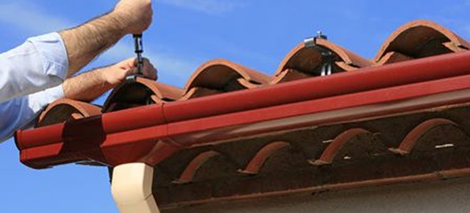

Installing the Gutters
Start at the end of the gutter away from the downspout location and measure down 1/2 inch (or the distance recommended by your gutter manufacturer) and make a mark. Move to the downspout end and measure down the same distance and mark it. These two marks should be level with each other.
Remember, gutters need to slope downhill, so at the downspout end, measure down from your mark 1/16" for every foot of run (or 5/8" for every 10 feet) and mark that position. Snap a chalk line between the lower mark (at the downspout end) and the single mark at the far end. The chalk line will be your reference line for installing the gutter components.
Working from your ladder, install the components of the gutter system - corners and drop outlets (be sure this is at the lower end of the run). Also, install the mounting brackets or hangers, positioned every 24 or 30 inches (follow your manufacturer's specifications). Be sure to use rust-resistant screws and align the components with your reference line.
Snap individual sections of the gutter into the hangers and join the sections with connectors. Again, follow your manufacturer's directions to allow for expansion and contraction of the vinyl. Use a hacksaw to cut sections to lengths less than 10 feet when needed to finish a run.
Install elbows to the bottom of the drop outlet, then measure, cut and install sections of downspout to the base of the drop outlet and fasten it securely to the side of the house. Another elbow and a short section of downspout directing the water flow away from your foundation complete your installation.
