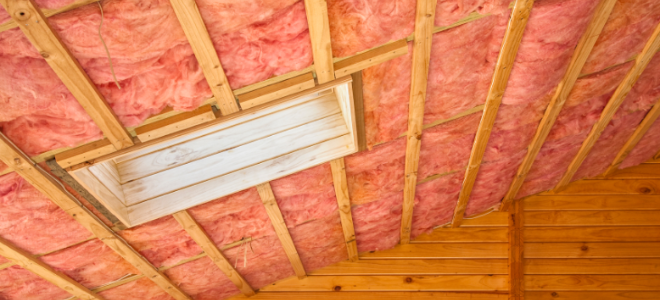

3. Materials
roll of insulation alongside tools
As with any home project the materials you will need depend on the type of insulation used and the extent of work being done. Your list will include many of the following:
