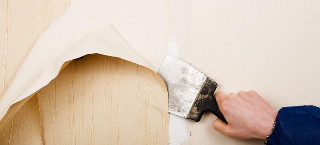

1. Use Spray Detergent
Someone removing wallpaper.
This tried and true method has been the standard technique for many decades. Simply fill a spray bottle with mild detergent and warm water and shake the bottle vigorously. Spray the solution on the wallpaper and let it sit for several minutes until it soaks in enough to bubble slightly. Then slowly peel the wallpaper back, urging the paper along with a putty knife. You can repeat this process as necessary to keep the wallpaper wet while you work. After all the wallpaper is removed, use a clean, damp cloth to remove any excess wallpaper glue that may be lingering. There may be several layers of wallpaper from years gone by that also need to be removed. Follow the same steps until you reach a bare wall and then your new wallpaper or other wall application can be applied.
