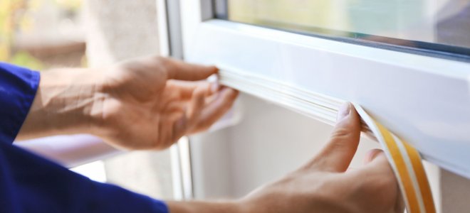

A man adds weather stripping.
Weather stripping is the process of sealing openings, such as doors and windows. This guide will tell you how to weather strip a few key areas of your home.

Self Stick Foam
Self stick foam uses a knife or shears and a tape measure. It is extremely easy to install, invisible when installed but not very durable. To install stick foam to inside face of jamb.
