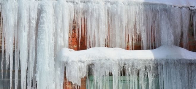

What Causes Ice Dams?
large icicles hanging from the side of a roof
It's hard to believe a warm sunny day in the winter can actually be causing major damage to your home, but it's true. That's because the runoff water from the melting snow (both from the heat of the sun and heat inside your attic), will run down to the edge of the roof. If it gets stuck there and refreezes, it can form a ridge of ice, aka an ice dam.
As more snow melts, the dam grows, trapping still more water in a vicious, chilly cycle. As it builds up, the water can work it's way underneath the shingles and begin to rot your roof, or even drip right into your home.
Does Attic Insulation Help?
Yes, proper attic insulation can help reduce the likelihood of ice dams forming, but insulation alone can't do it. Preventing ice dams also requires proper attic ventilation that allows airflow and movement through the attic underneath the roof.
A properly insulated house should have at least R-38 insulation (or even higher in northern areas), but only above the living area of the home. The areas over the soffits in the overhang should be uninsulated, with openings to allow for air movement
Outside air comes in through the soffits at the bottom of the roof, works its way up the underside of the roof and out the top through roof or ridge vents.
This cold outside air moving through the attic helps keep the temperature of the underside of the roof similar to that of the outside air.
