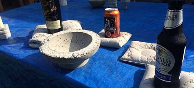

These bags are easy to find, very little money and all the ratios have been figured out but one. How much water? We’ll get to that. The aggregate is chunky, but the pressure against the walls of a form tends to create a smooth layer, pushing the larger pieces below the surface. The sides of this bowl are smooth as glass, where the mold form held it in. The top is rough, where the aggregate wasn’t held back.
Why Aren’t You Making Stuff out of Concrete?, Justin DiPego
If you want your surface to be this smooth, spend a little more money and buy the bag formulated for countertops. It only comes in larger bags, but chances are if you’re being this particular you’re building something bigger. If you try to sand and polish the basic mix you’ll quickly expose the aggregate, but the countertop mix is designed to be polished, so you can make your project shine.
