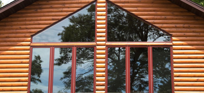

A home with a trapezoid window.
The trapezoid window is a beauty in any home. Modern homes are built with sloping roofs. The windows that are near the roofs are built to follow the slopes. While the trapezoid window adds eye-catching beauty, it is also difficult to use with window treatments because of the different sizes and angles. Generally, a trapezoid window will have two sides that are parallel. One or both of the remaining sides will have angles. If you are equipped with a few solid ideas, you can add window treatments to your trapezoid window.
