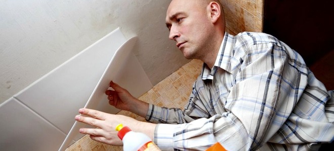

A man on a ladder installing white ceiling tiles.
Installing either a file or suspended ceiling in a 9 foot by 12 foot room will require 14 to 20 work hours, a host of tools and materials, careful planning, and two people.
