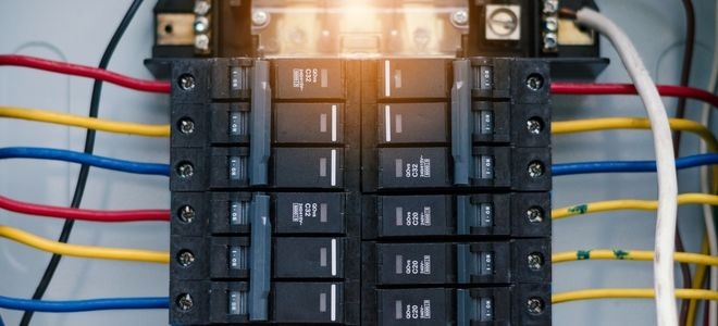

5. The Circuit Breaker Panel
From the watt-hour meter, the wires go down the conduit coming out inside the circuit breaker panel (Fig. 6) where you can see the two black (hot) wires connected at the top terminals of the main circuit breaker with the other side of the double breaker connected to the two Hot bus bars, while the white wire is connected to the panel’s neutral bus bar. The main breaker in figure 7 lets you cut power to the entire panel when necessary.
The two bus bars connected to the main breaker are shaped as a series of fingers crisscrossing alternatively between both bus bars and each a terminal to every breaker feeding a circuit within the house.
circuit breaker main panel
