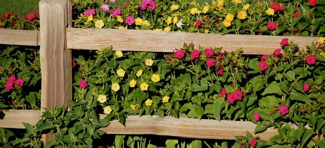

Modern split rail fences have evolved and most split rail fences these days use fence posts with holes cut through them to allow installation of three or four horizontal split rails between the posts. This design uses substantially less wood and allows the fence to run in a straight line, but it does require more up front work than the traditional fence that was ideally suited for rocky ground since it didn't require any digging. If you want to have a traditional looking split rail fence around your home, here's how to build your own.

There are three kinds of posts in a split rail fence - end posts (the holes only go part way into the post), line posts (the holes go all the way through) and corner posts (have holes at right angles to each other).
