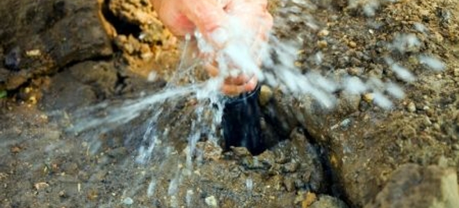

Lawn Has Standing Puddle
If you find a puddle of water in your lawn, then you probably have a leak in the system line.
  • Shut off water to the sprinkler system
  • Carefully dig up the ground around the leaking pipe
  • Cut out the section of pipe that is leaking and insert new piece of PVC
  • Glue it into place using a PVC cement
  • Turn on water to see if the problem has been resolved
  • Fill in the hole and patch the sod
